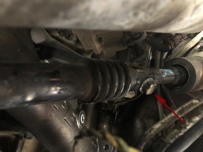

    Step 2: Locate the 15mm bolt behind the driver fender well in the engine bay and remove.
    Click image for larger version
Name:	steering shaft-1.jpg

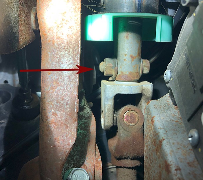

    Step 3: Locate and remove the 15mm bolt to be removed under the dash on the column
Name:	steering shaft-2.jpg

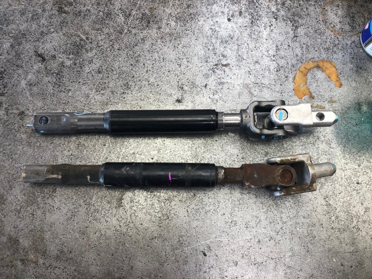

    Step 4: Remove the steering shaft

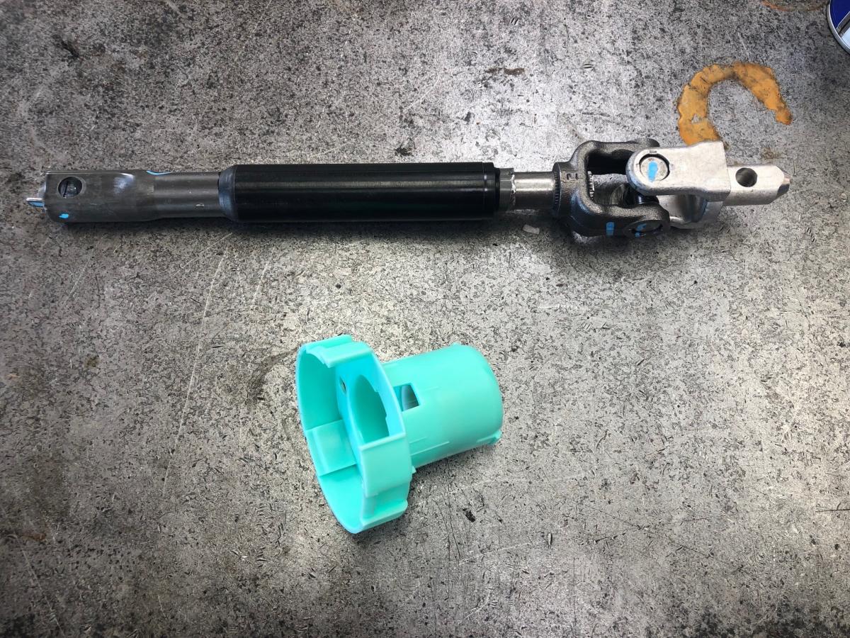

    Step 5: remove the old collar from upper shaft, this is where you want to make sure you do not clock the bearing.
    Tip: May be necessary to sand and smooth some of the upper shaft end to prevent premature wear on the new bearing.
