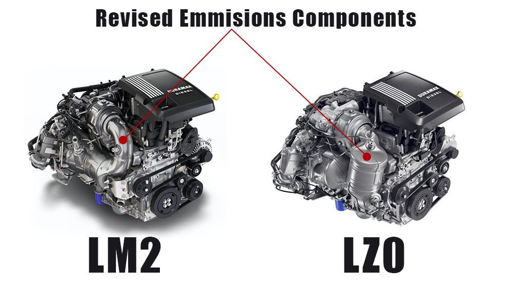

The most noticeable difference is the revised emissions components. You can see in the graphic below the Diesel Oxidation Catalyst, DOC, has been moved closer to the turbocharger for improved efficiency. This is a simple way to tell the difference, you can just pop the hood and look at the turbocharger.
